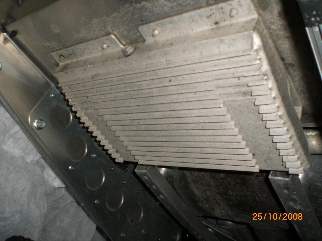

I have a '08 APEX LTX and have added a rear cooler and also diluted my coolant, drained 2L and added DISTILLED water and never overheated once or fan come on...here's a pic of my rear cooler I don't run studs so I didn't extend the protectors.

sj said:save ur money....dilute the anitfreeze with distilled water to a 60/40 mix and you'll be fine..
what sj said, your mix from the factory came too strong. I've run glare ice drags all day and have never seen my temp light come on.
yamaouch08
- Jan 17, 2006
- 439
- 973
- Otisville,Michigan
- www.chapmanssports.com
I agree 100% with both these posts. 60/40 mix here and I never had the temp light come on with my 06 Apex I had, or my 08 Apex.my dealer checks them at set up to make sure they are 60/40 if they are not they change them to be 60/40 mixBA APEX said:sj said:save ur money....dilute the anitfreeze with distilled water to a 60/40 mix and you'll be fine..
