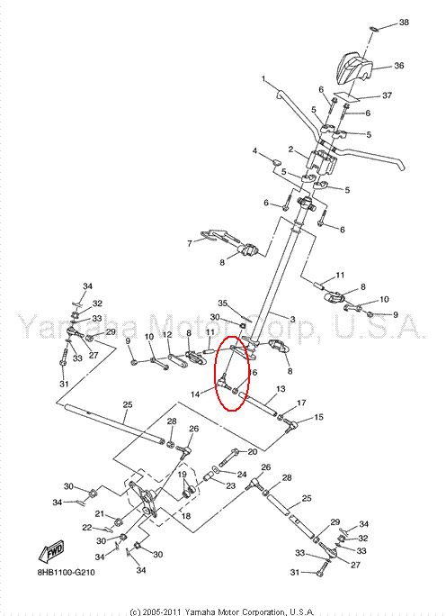

I noticed the bars are off by about 1% or so. When you point the skis straight the bars are off to the right a bit. The sub frame is not bent, no chips on paint, shocks still in the center of the a-arms. How do you adjust it so the bars are straight with the skis?

Adjust your tierods. You'll have to shorten one and lengthen the other. One method is to align your skis off of your track say using some straight edge or straight 2x4's ( I use a chalk line). Lay or snap them along the side/edge of the track projecting out to at least midway and beyond of ski. Straighten or "centre"your handlebars by measuring bar tips to running boards. Now ratchet strap and or bungee the bars straight/centered at equal heights from boards. Now adjust your tierods until skis measure equally or square to boards/chalkline from at least 2 carbide studs on each ski. Adjust for proper toe out. This way you'll be a straight and true as your track.

That should work!!Superman said:You should just be able to adjust the 1 ball joint on the steering plate at the bottom of your steering column/post.
..SNAKEBIT..
I would FIRST check toeout before adjust the bars,
you might have knocked out the toe and this could straighten the bars!
If toe is good then adjust at the bottom of the post. IMO
Good info guys. I knew I could count on you. I will check the toeout and if that is good, I will adjust the bottom post. Like I said, it is just a tiny bit out but it drives my son crazy and I can see why. It would bug me too.
