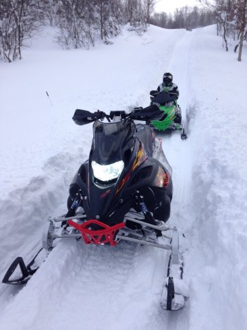

Subframe or a arm gone???
i would say it's a virtual certainty your subframe is pretty well tweaked. I have yet to see a nytro with a perfect subframe. If your a arms are bent the subframe is definitely bent.
You may be able to give it the pry bar treatment and keep riding it for a while. My 09 XTX bends over time and the spindles stand up straighter and the shocks get closer to the upper a arm.
My 08 one whole side is pushed back like yours and the entire frame is twisted up bad. No way to fix that.

It's not bent just not wanting it to get there when I can ride again. (herniated disc has sidelined me for a second season, probally now done the rest of this year).
How do i do the pry bar method, i have been driving the dam thing. don't notice much difference to be honest. put a 120 kms on it Saturday.
