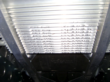

Today my die hard Polaris mountain rider friend came over to have a look at the Apex. Checking out suspension and Ron noticed damage to the rear exchanger. Wouldn't of thought with the tunnel protectors there this would of happened. Track is 1.25 and studs 1.325 but obviously they're hitting! I have some old sliders around somewhere so will probably rivet some 1/2" high strips onto the metal ones already on the machine.
Anyone else have something similar happen?

This in on an LTX right? This is common. The ripsaw has soft lugs and will bend some allowing the studs to hit the cooler. You have to put extra protection on the tunnel protectors. After sorting threw lot's of posts for a year now one guy that had the same thing happen said at least 1 1/2 in clearance between cooler and outer protector up to the back of the Bogeys. Any further up the track will rub.

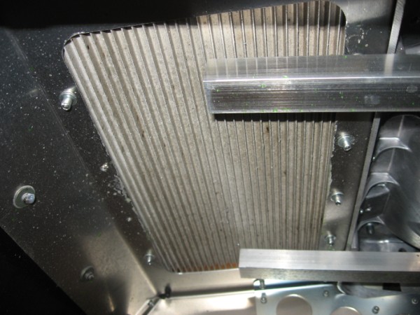

I just studded mine and riveted an old Hyfax on top of protectors. I hope this does it. If it doesn't I'll have to add more. Or take the studs off.
I don't know if there is a sure fire way to prevent this out here yet. I've seen guys rip the cross over piece under the muffler on some sleds. I'm not sure it's the long track,short track or both that it happens too.. But I'd get it out to 1 1/2 in. at least for now.
Maybe someone who runs LTX or ATTAK with these studs will give a good answer. Trouble is lot's of guys chime in that have short tracks and confuse the issue or just speculate.

Thanks for reply and info about the 'soft' track. Yes it is a LTX. Looks as if the tips of studs are 'clipping' the exchanger cooling fins. Don't seem to recall really bottoming out suspension so may get worse if I did.

.I don't think you have to drop the track. With the sled on the floor I took out my Bogey wheels. Then raised the sled in the air. I used an angle drill to pop rivet the Hyfax onto the protectors.
In your case you have to measure how much you need to add. My 07 Attak had the cooler added on after I bought it. It is a different cooler.
You will have to put more then just the Hyfax too get this amount. Home Depot sells Aluminum Flat stock,etc. You only need it from rear of sled to just behind Bogey's. Taper it as you get to the Bogeys.

I tagged mine, just rivot a used hyfax to it and you should fix the problem.
