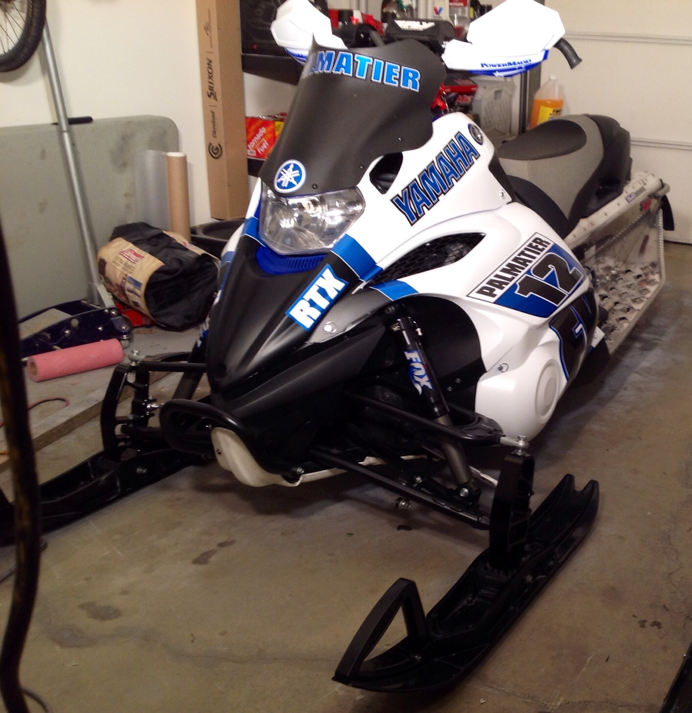

This will be a slow project, but here's what I got so far. Gonna meet with graphics guy to do some stuff with it also.
Current list updated and very excited for this season with the new shocks, seat, relocate, and skis along with a few helpful power adders I'll have a fun toy that rips I think!
Side panels are done with graphics.
Excell titanium header
Risers are 4" fly
fly carbon sno-x bars
C&a skis
Oilite bushings are in.
128" relocate with ice ripper is installed
Jre spindles
Mountain tech ip vent
Axis pro series shocks 18.25"
- gives stock ride hight and more travel with the jre spindles for improved handling and bump compliance
Hygear trail pro rear shock package
-bladder kit in each shock
-dual rate spring kit on center shockk
-hylo valves installed
-hyflo hose kit for resivoir
-hyflo valves
Wrp seat
Oft relocate
Skinz airframe running boards
Pc3 from ulmer
Pc ignition module from ulmer
K&n intake from ulmer
Oft 2 wheel big nuts axle
Muffin works 5 step spring cam

Well maiden voyage is in. It was damn cold for most the day and the snow was sugary.. However considering that the sled handled great. Never lifted the inside ski and rode great. At 100psi on front shocks. Thinking might be better in the 80-90 range but that's just something minimal to play with down the road. All in all I'm very happy with the changes and with a good solid base an a touch softer front end think it will be as good as anything out there. Heavy in steering but again that's minimal. An fixed by the oft relocate once Time an cash free up.
Jre proto 3, float 1s@100psi, tuners with 6" square inside runner an 2" round outside runner. Rear springs on still, not sure where center spring or comp rebound settings are on rear shocks at moment
