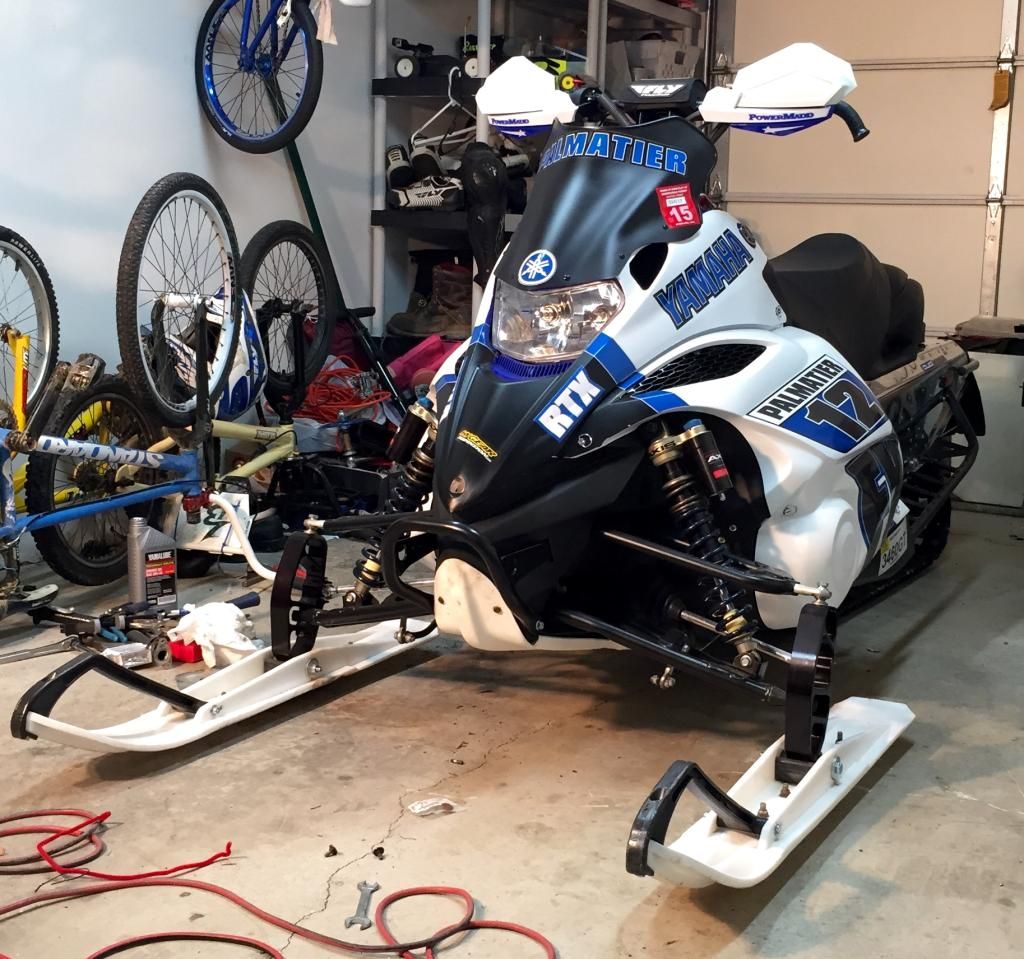

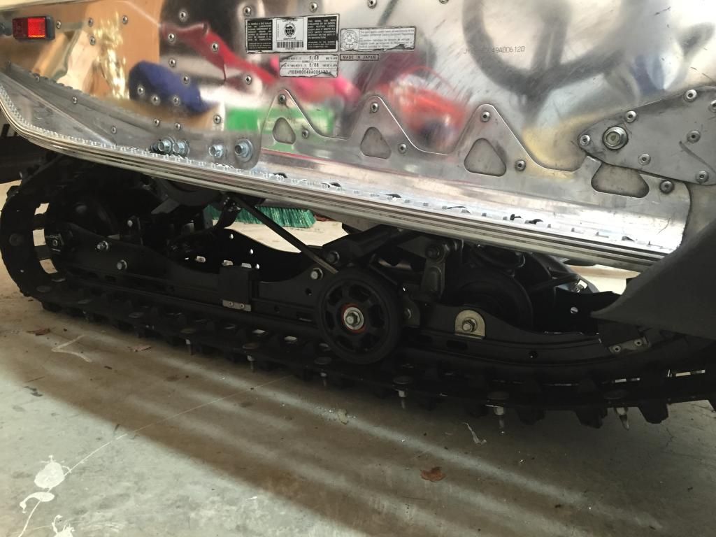

Current updated photos and list of parts added this summer hope you guys enjoy
Axis shocks
Hygear trail pro pkg on rear shocks
Dual spring center
Bladder in place of floating piston
Hyflo hose
Hylo valve to allow larger range of adjustment and high low speed adjustment to both rear shocks
C&a skis
Oft rear axle
Oft relocate
Wrp seat
Mountain tech ip vent kit
Pc an pc ignition module
Ulmer intake

Nice work!
uofm
That is the nicest looking sled I have ever seen.
