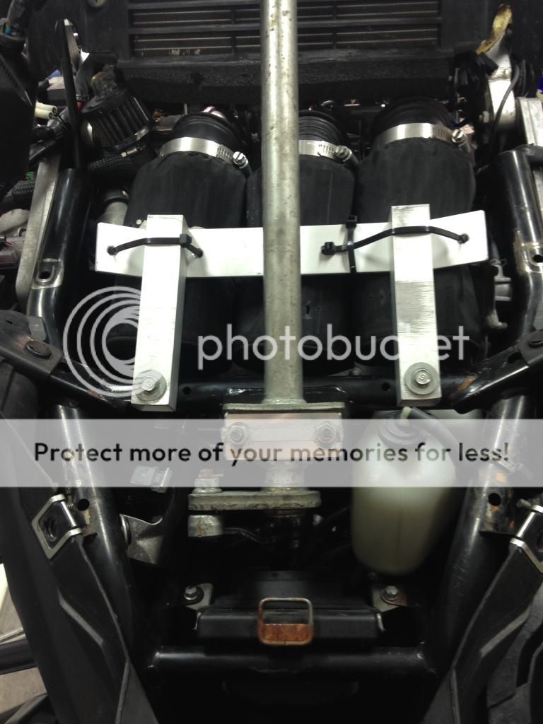

Well maiden voyage is in. It was damn cold for most the day and the snow was sugary.. However considering that the sled handled great. Never lifted the inside ski and rode great. At 100psi on front shocks. Thinking might be better in the 80-90 range but that's just something minimal to play with down the road. All in all I'm very happy with the changes and with a good solid base an a touch softer front end think it will be as good as anything out there. Heavy in steering but again that's minimal. An fixed by the oft relocate once Time an cash free up.
Jre proto 3, float 1s@100psi, tuners with 6" square inside runner an 2" round outside runner. Rear springs on still, not sure where center spring or comp rebound settings are on rear shocks at moment
Lots of changes coming.
-airframes
-k&n intake
-pc with ignition module
-oft relocate
-oft big nuts rear axle
-c&a skis
-axis dual adjust front shocks
-hygear trail pro pkg on rear shocks
-wrp seat
-mountain tech ip vent
-DuPont slides
... Wanting to get a 4" tunnel extension but having trouble finding reasonably priced one, and Powdercoating rear suspension. Also need the 5" idlers and unsure if I want excel or just replace factory. photos coming soon. Panels need some touch up and slight graphics changes on way too

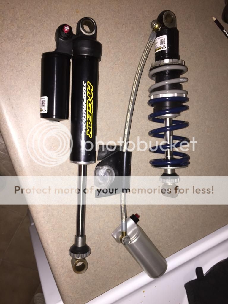

Guess when out of town for work all the time a makeshift shop is needed. Here's mine. Built my suspension tonight. Only have to pop the front and rear arms off to get a bit more paint on them, they are looking dingy.
