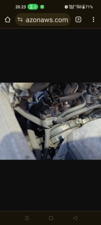

I had just exactly same issue with my fx nytro! but i found the problem and solved it. It just take 5 days to found that issue..
I have wrote this text in youtube, so read and visit our sledpage to see fotos.
(You can use google translator to read our texts)
solved!! there were missing rubber pacifier next to carburetor. (there is 3 rubber pacifier next to each "carburetor".
In my nytro that rubber were missing in cylider 2 carburetor.
go this website:
https://kelkkalehti.com/keskustelu/index.php?threads/fx-nytro-rtx-keskustelu.8499/page-321
Look my fotos.
my member: "iceACE" and page is 321
