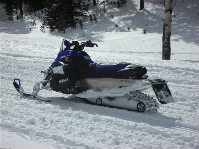

Scooter700
I just rode the XTX in W Yellowstone yesterday along with checking out the new 09's. If you get a chance, you got to ride this. All the reviews are correct and you don't even know its a 144. This setup rocks!!
