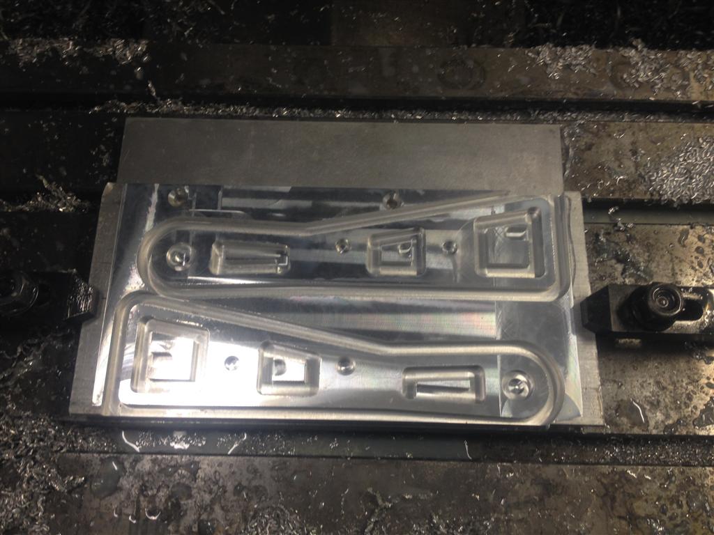

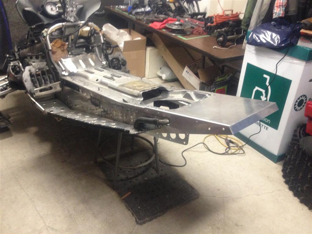

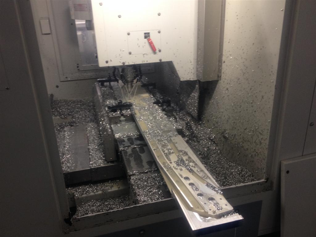

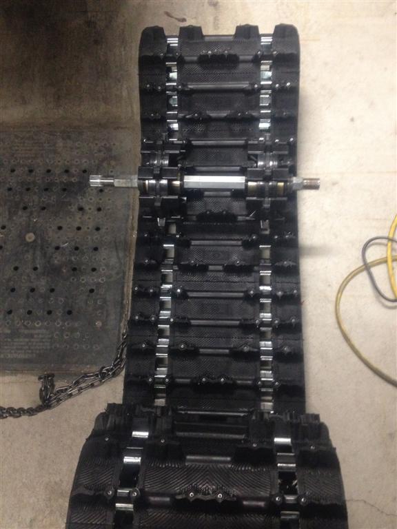

Update on my sled build, I made a set of 144 rails from aluminum flat bar on the cnc, I made them tipped up in the rear like the XTX's, tip up goes back 11 1/2 inches. I added a tunnel extension, side mounts for spare gas containers and a rear rack for additional storage. I got 4000klms on the new set up so far this season and it's running flawless, love the 144 Ice Attack track.
Unfortunately i could not move the upper rear wheel back to maintain the same geometry, the steel bracket for that wheel mount also shared the mounting of the rear swing arm thus changing the geometry. Anyways working real good like this.
A few pics below enjoy.
