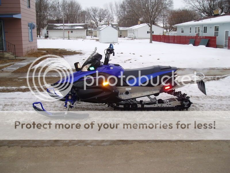

I have an Attak extended to 151" using rail extensions with no problems in 1000 miles of off trail riding. I can also get billet 144 or 151 rails made as well (these rails are stronger than stock rails also).

Do you have any more photos or details on this extension? I am looking to extend my Apex from the factory 121in.I have an Attak extended to 151" using rail extensions with no problems in 1000 miles of off trail riding. I can also get billet 144 or 151 rails made as well (these rails are stronger than stock rails also).
What did you do to make the rear deck extension?
Also do you still make these extensions?
You can still get rail extensions and tunnel extensions from Tracks USA for an Apex. The longest they make for a 121 suspension is to make it into a 144 tunnel & rail length.
