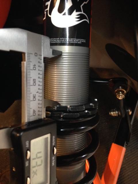

this is where I have my shocks. Its in mm. Its measured from the top of the adjuster ring to the LIGHT thread on top. Its the very top shallow thread where I measure from.
FRONT SHOCKS
FRONT SHOCKS

Hi again Jon,is that close to 43mm which is 1.6899 thou. man nice looking spring,raptor sounds like a good company,for 60 bucks,i may just have to get one,now the big question,is it possible to install that spring w/out removing the skid,this is where I have my shocks. Its in mm. Its measured from the top of the adjuster ring to the LIGHT thread on top. Its the very top shallow thread where I measure from.
