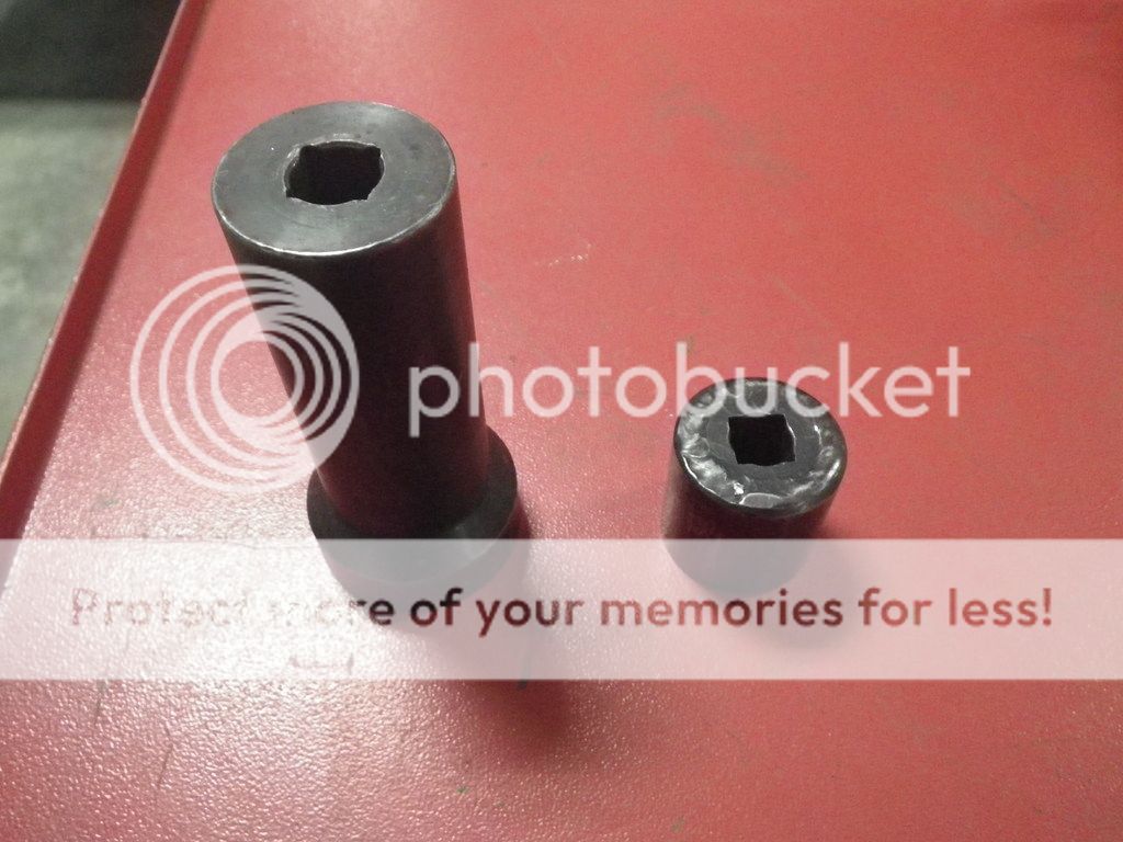

I need to remove this nut in the drive chain housing and need to get an axle nut socket of the correct size. Does any know the actual size in mm that I need? Hoping not to order the wrong size.
The size of the nut is 36mm. The torque of the nut is 65 ft lbs.
Here is picture of the socket to removed the nut, the smaller piece is to hold the jack shaft from the other end. Need to removed the secondary clutch.

Thanks. Do you know where I could get one? All of the typical axle nut sockets just don't seem deep enough.

just buy a cheap 36MM socket, I cut in half and welded in a piece to make it long enough-ugly but works and cheap.
