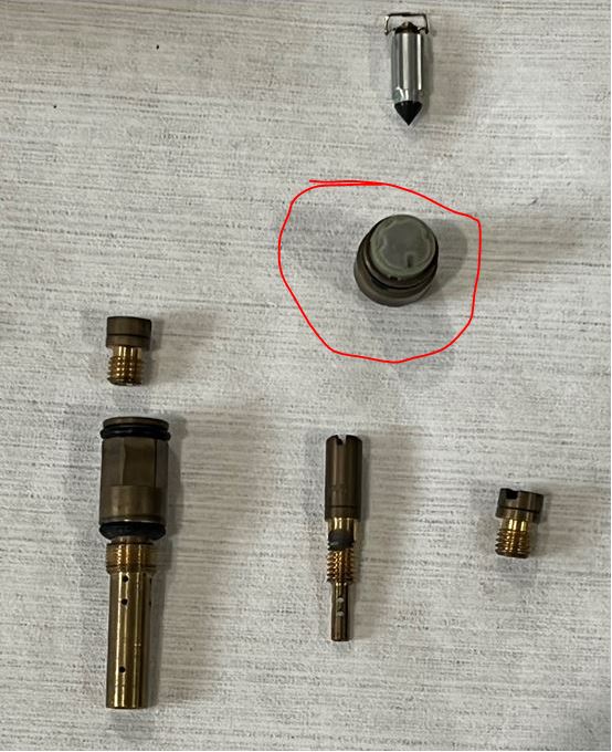

RobX-1
- 2,580
- 1,735
- Coldwater, OH
When you disassembled the carbs, did you also remove the needle valve set and clean those screens?

ymhajoe
- Jan 25, 2014
- 16
- 703
- Austin ,mn
- 2011 PHAZER RTX,2000 SXR 700, 2003 VIPER MTN
I did, basically had to ultrasonically clean everything and replace all the rubber O rings in it. Got way more time into it than I wanted. Cleaned alot of carbs in my day but this was by far the worst. Didn't look like a bad deal at $900 depending on the actual (evilbook marketplace) condition.
