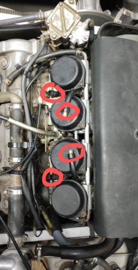

Got a 2003 RX-1 that starts right up with choke on, then idles perfectly. When I hit the throttle it stumbles (and will die if pressed). If I put the choke half on, it will rev up so it's definitely a lean issue. I have gone through the carbs multiple times, all jets are clean, new pilot jet o-rings, even tried new pilot jets. They are stock sizes and I'm at 3400' so if anything it should be rich. Pilot screw set at 2 turns out, also tried 2.75 out to see if related, no diff. The rubber piston valves are not warped and seated good. The o-ring in the piston valve cover is ok. The carbs are seated good in the intake boots, the airbox boots are seated good as well. It feels like it's a vacuum issue that should be raising the piston valve on accel but don't know what happens in the process of accelerating. In the attached photo, I don't have the top vents connected yet, could that possibly be related, don't see how but asking anyway? I did not separate the carbs from each other, could there be o-rings between them or choke valve o-rings leaking air? I'm at a lost as to finding this and appreciate any help in advance.

I have you checked the throttle free play to ensure it's not a TORS issue preventing the engine from reving up? Knowing the condition of my in-tank fuel filters when I replaced them on my RX-1, have you inspected yours to ensure they are not plugged/gummed up? When you had the carbs disassembled, did you also remove the needle valve and inspect those little screens?

I have TORS bypassed. I replaced the needle valve and inlet brass screen as well. I have not removed the in tank filters, good suggestion...

Each time I remove the bowls the fuel is clean and I've removed the needle seats to see if new junk on the screen and they were clean. That being said, I'm going to check the filters this weekend and smoke the boots for leaks.
It's history... Got it from a friend this summer, has 900 miles, had been sitting for a few years with no fuel in it. First thing I did was clean carbs, they weren't bad, jets were not clogged. It starts immediately and idles perfectly smooth, so weird.

You make a valid point. As much as I think that I removed a jet, cleaned it, then put back one at a time, I could have screwed that up so I definitely need to recheck them. If I indeed swapped the jet named power jet in parts diagram/starter jet in svc manual and main jet that would do it.

if all else is checked and good check carb sync as suggested. one other thing, I know you think it’s lean but being too rich with the pilot screws causes exactly the same thing. Im at about 1000 ft and mine ended up around 1.5 turns out. It was last year when I last set them. But at two I was seeing very rich mixture. Some thing like 10.9-11.0:1. At 1.5 turns its about 14.0:1. Yes, I use a portable wideband left over from my EFI tuning days.
