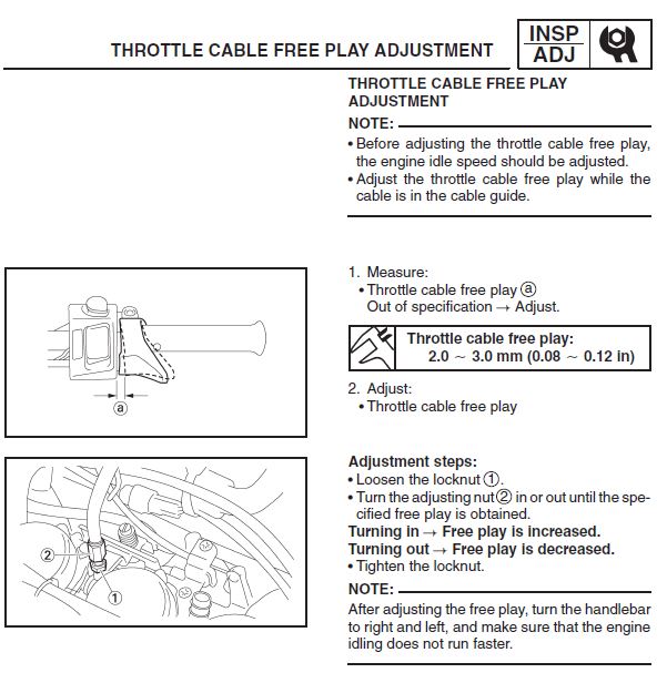

No, but you might want to check/confirm your throttle cable free play as its possible you had the handle bars slightly turned when initially setting the idle where if not sufficient free play in your throttle lever, caused the RPMs to rise and not allow you to get below 1600.Did working on a snowmobile in summer heat play a part?

Yes, very likely what I did. Thanks!No, but you might want to check/confirm your throttle cable free play as its possible you had the handle bars slightly turned when initially setting the idle where if not sufficient free play in your throttle lever, caused the RPMs to rise and not allow you to get below 1600. View attachment 173290
