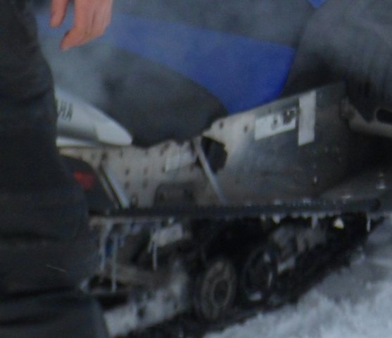

See the brace in the center of the photo, I put that on 4 or 5 years ago and hasn't cracked since. cracked twice on this side and once on the other. I know it's not the prettiest thing but it works.

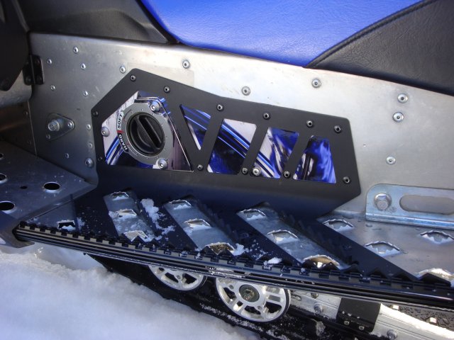

Like steiner said, it all depends how you ride whether you need the tunnel supports or not after you get this repaired. The last owner could have simply rode that sled hard, or if he was 280 and stood up on every bump, somethings got to give. Here is a tunnel support from Yamaha made to fit, with rivets, if I remember right, about 140. $. Just leave a couple rivets out where the heat exchanger is(don't drill through it), or move that rivet install over a little. Sorry, the decals are extra.Did you put running board stiffners on? Wondering if a fabricator could make a bracket our plate to stiffen it up more...?

What did you make that out of? Looks simple, but strong, maybe that in combination with the tunnel stiffners the guys mention above should solve it for a good while?? Just got to taking everything apart and its the throttle side with a single hairline crack... Weld time I guess!View attachment 116115

Just cut them from some sheet stainless approx 1/16 thick and put a 90 deg bend along the length. they are about 5/8" on one side 3/8" on the other.
The reason I replaced my exchangers was that you can make a weaker point on the aluminum when welding the crack closed. Welding the crack makes that area stronger but can add more stress to the areas beside that weld. These exchangers need to flex as the rider puts weight on them. A good weld job could very well solve the issue for a long time especially if you are a sit down rider. If you tend to stand you will flex and load the exchangers. This is where the tunnel stiffeners come in. They distribute the weight over a greater area reducing the stress and flex on the area where this leak happens.
If gitrdun is correct on that price the Muffin Works stiffeners are half the price and with the choice of lettering and color it was an easy choice for me.
I added the blue in behind them.
