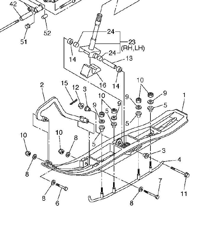

The parts you will need to convert to to the Yamaha mtx skis are, pre-2012 mtx ski, rubber mount, spacers, bolt. Look up the parts on yamahas site for the vector/apex mountain so you get the right rubber mount. Easy swap out, you will be glad you did it!

Looks like you need, 11x2, 13x2, 14x2, 16x2 and 24x2.
