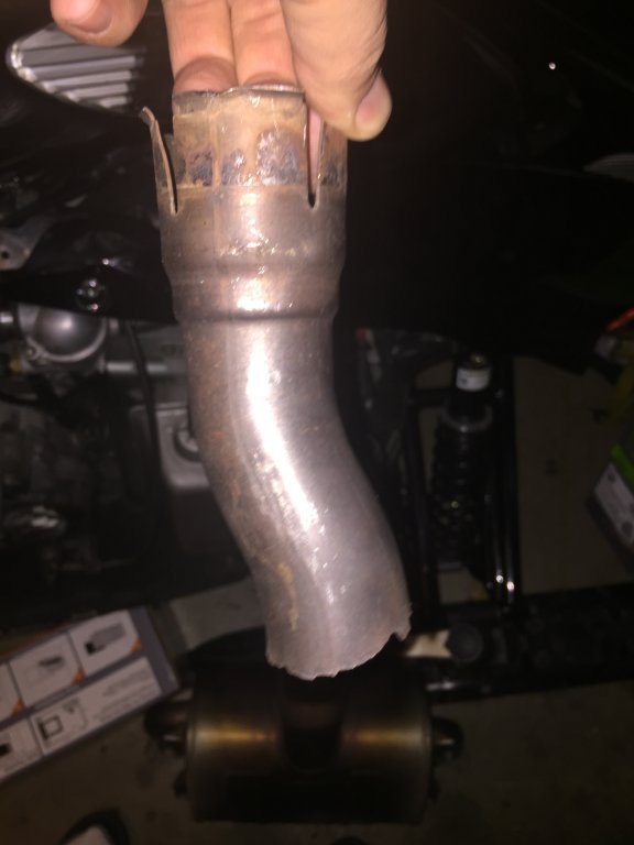

Its stainless but I found that any old regular Mig welder welds just fine.
Snapped mine in the exact same place.

Thanks!!!Its stainless but I found that any old regular Mig welder welds just fine.

MIG, with fluxcore wire is the best to use on these vs TIG, as the soot inside the pipes contaminates the weld puddle and blows through. Been there done that
If you ever need to replace the muffler, look for a used 08+ Apex muffler, they put a reinforcing plate across the pipes with a rubber iso-mount to the tunnel in the area where these are breaking, pipes must be flexing and work hardening over time.
Cheers
Cheers
