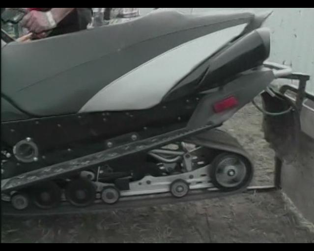

Do these mount to a cross bar or are they stand alone, each mounted to a rail?
Is this the kit?
http://www.yamaha-motor.com/sport/produ ... etail.aspx
Something like this?
