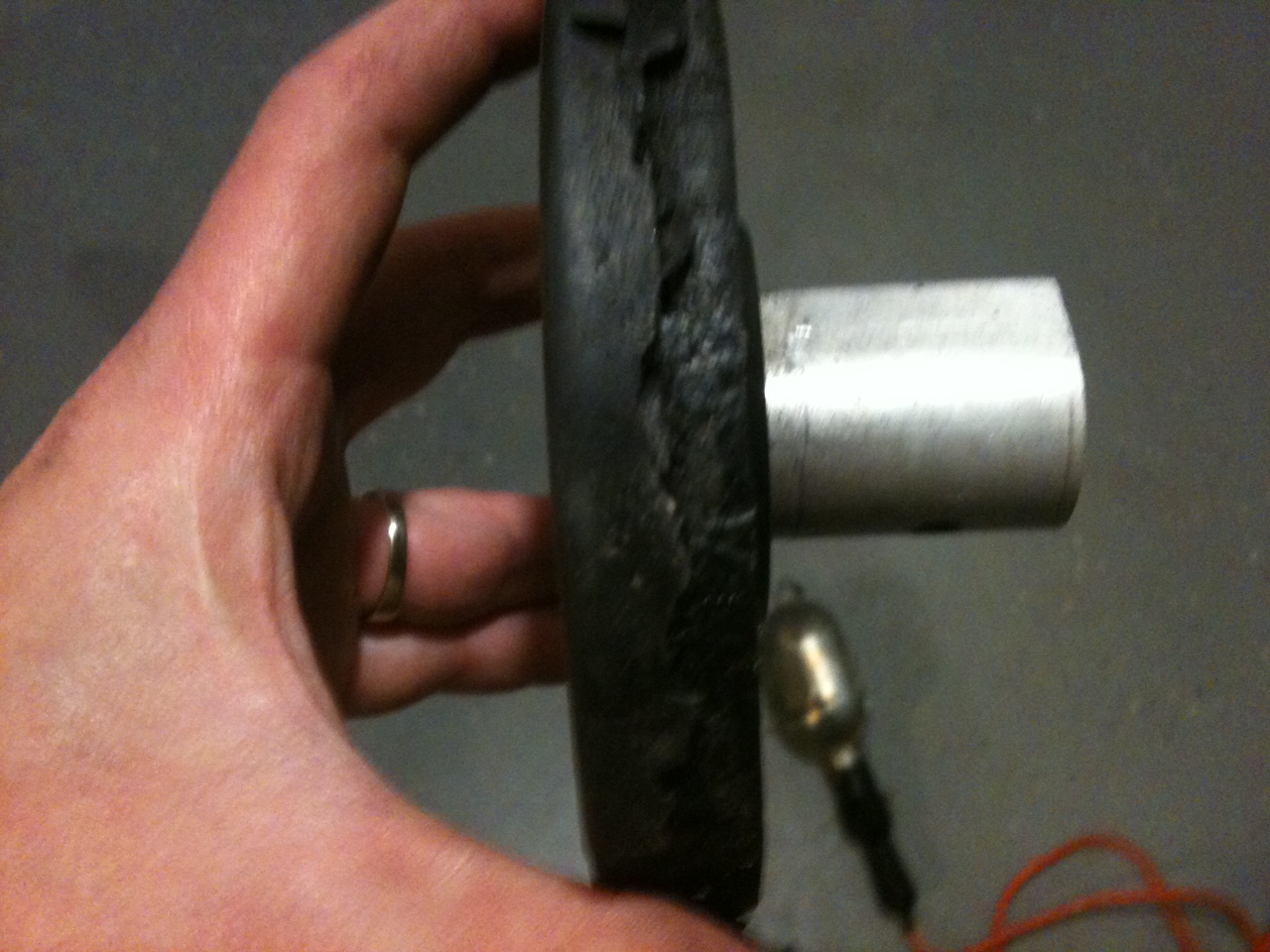

Finally, got those bastard inner idler wheels off today. What a pita.
Anyway, how do u separate the idler wheel from the backer? see pic below.

nothing holds it on, its just corroded on. open your vise so that only the aluminum stand-off is through, then find a socket the size of the inner bearing race and pound the stand-off out.
X2..... or couple blocks of wood, and socket... pound away... and FYI... 6005 bearing... only one that will fit. unless mods of course..
