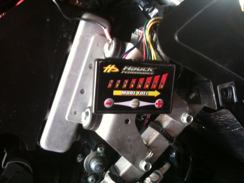

UPDATE & "THE CAUSE"
Hello,
Well what we think is "the cause" {the connecting clip/wiring between the ignition and the rest of the electrical system} after 684 miles, all the other connections are OK, fuses are all 100% OK as well as the relays...
Thanks,
M
P.S. I have posted a few pictures, one is of the cause and the others are some of the upgrades that were on the sled that was purchased...
P.S.S. Hopefully "the cause" picture will help someone else...
Hello,
Thanks,
M
