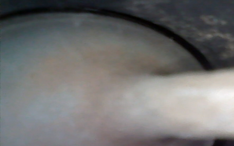

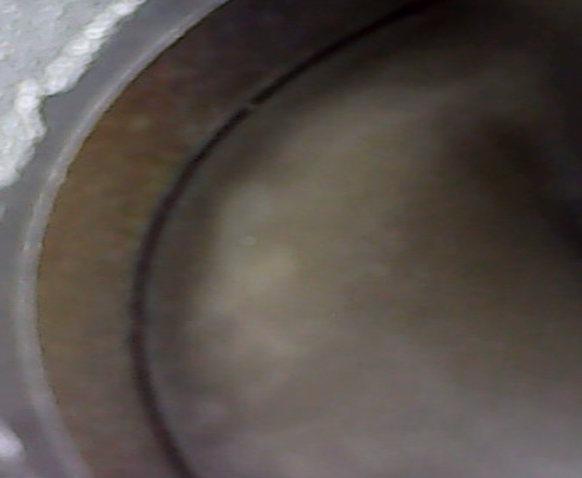

1st image is intake valve with lobe up. Exhaust one looks like it’s closed now but at TDC with timing marks aligned with arrows both valves are open. See 2nd pics, intake then exhaust.

Could valves be bent from the shifted shims? I rotated the crank a few times to get the tensioner to release, didn't feel resistance so I did a leak down test and it failed. That's what lead me to pull cams and check bucket shims. I'm thinking I may have to pull the head.
