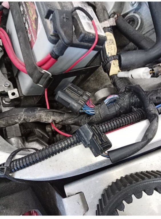

This is the 1049 in a cat 7000, but id think this is similar to yours.
So you have the three red/yellow in that connector block and also four pink/blue in the other. Flip the tops of those open and slide out the metal joiner and inspect.

I will look for those blocks tomorrow morning. Just had it out for a ride and it was come and go with the code. No rhyme or reason when it throws the code or clears, so I'm thinking it's wiring somewhere.

Only 2 blocks I could find off the harness where the ISC wires are.

The other block lower down. All are clean. The 2 square blocks the upper has black wires only. The block beside the throttle body has only red/white wires, no red/yellow. I don't see any other blocks.

I don't have a one like yours here at the moment so I can't say for sure where to look, except near the fuel rail.
Sometimes they are wrapped along the harness in electrical tape.
