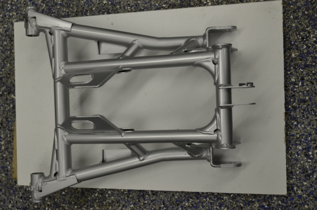

I received the 2010 W arm for my sled. Here are some pics for people to compare with what they currently have.
There is one issue with this and the 2007 arm. The transfer rod tabs have a bolt hole that is larger than the 2007 arm. The bolt hole sizes are .410" for the 2007 and .495" for the 2010 bolt hole, and the tabs are .120 further apart on the 2010 arm. Also on the side of one tab they have a washer welded with two striaght tabs of its own protruding as if to stop the nut from rotating. I looked up the nut for this and oddly enough it looks like it has a flange in the picture which would mean the tabs by the washer wouldnt work any way.
My remedy for the larger transfer rod bolt holes will be a stepped washer on each side that will both reduce the ID of the hole as well as the width between the tabs.
Arm was just under $300.
Goes to show what good value you get from Brian when he modifies your existing arms.
