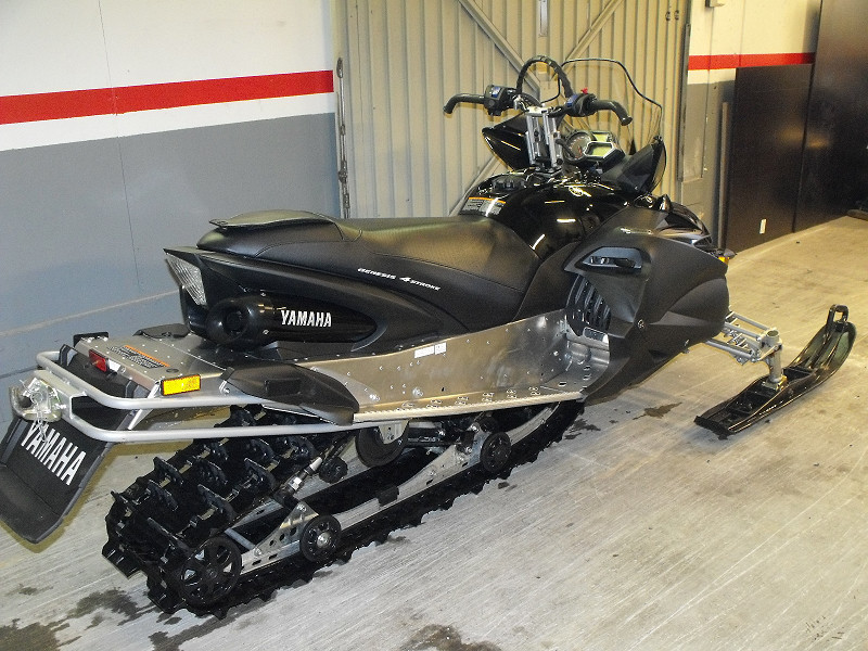

This picture is from a sales-ad in Norway, but shows the same tow-hitch I use. I think almost every XTX in Norway got this one mounted.
I do longer trips all the time, often towing 500lbs or more with fuel and equipment on the sledge. On my last two xtx's the upper tube has broken on one side close to the hitch after about 6000 miles, but it holds up all the way home and then just replace it for 180$. Very happy with this.

They are made by a lokal firm in Sweden and are sold in scandinavia as a oem.
Ya I talked to someone else over there that has the double bumper setup rafts why I was trying to modify the older model ones that yamaha makes. Unfortunately it wouldn't work and my dealer said they have no way of getting the Sweden ones.
