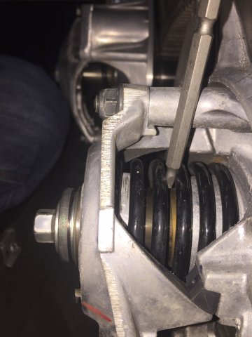

Bud you have problems there, that spring will bind big time.
ranger1
What kind of aftermarket helix is that? Maybe it is the wrong spring for that helix. In the pic the angle looks steeper than stock. That looks like the wrong spring also, should have only 5 coils instead of 6. Thought your sled was stock?Not sure what the marks are. I seen them too and thought just a poor casting and clean up at the factory. And the spacing between the spring on your pic looks big compared to mine. I can fit a #2 Robertson tip between mine. View attachment 114389

It is stock. If anything is different on it, it was changed at manufacture or at dealer and nobody told me otherwise. I got it a year old in the crate and seen them bring the crate inWhat kind of aftermarket helix is that? Maybe it is the wrong spring for that helix. In the pic the angle looks steeper than stock. That looks like the wrong spring also, should have only 5 coils instead of 6. Thought your sled was stock?
I'm thinking that's what's happening and am gonna talk to the dealer today. Hoping someone that has a clue will answer the phoneBud you have problems there, that spring will bind big time.

The part # for the helix on my 2012 XTX is 8fA-17604-00-00. I checked & they use the same helix for your 2011 se. Let us know what the dealer has to say.

After reading that you reassured us that your sled was stock I went to the garage to check mine. I made a mistake, I thought my stock helix looked like steiner 's but that's what my aftermarket one looks like! My stock one looks like yours, (aside from the grind marks)
I even took a pic of the stamped part #! Sorry for my error!

Ya I got same stamp. And yours dose look like mine. And I would like to know why the grind marks are there. Who effed up there I wonderAfter reading that you reassured us that your sled was stock I went to the garage to check mine. I made a mistake, I thought my stock helix looked like steiner 's but that's what my aftermarket one looks like! My stock one looks like yours, (aside from the grind marks) View attachment 114426 I even took a pic of the stamped part #! Sorry for my error!

its factory balanced lol
Sled was too fast.. They were trying to take a little off the top by clutching. Apparently it was that guys first day and took it literal.

Ha. Let's hope it gives that jack shaft bearing a lil more lifeits factory balanced lol![]()
ApparentlySled was too fast.. They were trying to take a little off the top by clutching. Apparently it was that guys first day and took it literal.
Thanks for the helpful info guys. Now we just need some snow to fly
