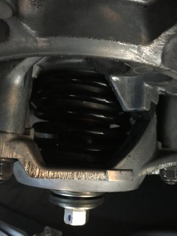

Now when you say fully collapse it. You mean with the spring out and in my hand? Because I did that and ya I squeezed it together totally with one hand. Where as the clutching on say my maverick I did some clutching to it as the factory stuff got soft from heat. But when I took that secondary out and squeeze it. I need two hands and can't get compress it any more then down to about 3" long, not compressed its 5.25" long. Could it be just a bad spring? I ment to call the dealer for a new one but to get any helpful info on parts from them is like getting snow in July. Also in the picture below if I've done it right. It looks to me like the spring is way to close together like there's not enough room for the clutch to open.
Is it still at 9 and 1?? Whats with all the grinding marks on the clutch? I have a spring here if you would like to try it.
The spring I have loose here takes both my hands to fully compress it.
My secondary looks like this with an aftermarket helix but the spring and spacing of the winds will be the same as stock.

Not sure what the marks are. I seen them too and thought just a poor casting and clean up at the factory. And the spacing between the spring on your pic looks big compared to mine. I can fit a #2 Robertson tip between mine.
