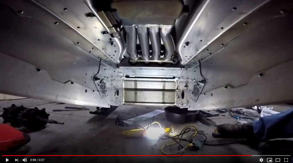

Bump - @mbarryracing (saw an older thread with a picture of your apex that looked like it had 1.575's in it. What is the max length I can run on this 2011 XTX with an 1.25 track. It has the factory tunnel protectors - i'd ideally like to get a 1.575 under or a 1.450 at a minimum....hookup with the current 3 per bar up the middle and this supercharger is non-existent.

I pulled the exchanger protectors in the tunnel and up front when I installed the 1.6" Ice Cobra. I have not seen any scratches from contact so far. I probably could have gotten away with leaving them in. But at this time, there has been no contact.
I'm sitting at around 4500 miles on this track.
Good luck,
Good luck,

Thanks a lot for the quick response - were your protectors welded in to the tunnel? I have not installed protectors on an Apex but the ones on this XTX are welded at the front of the tunnel where the track goes around the drivecogs. It also appears to be welded at the back and at certain points along the whole length of the tunnel. If you can run a 1.6 inch track with no contact I think I should be OK with a 1.450 stud - will wait for a couple others to chime in but this leaves me optimistic.
Good luck,

I would agree with that, you should be good to go. The front one is welded, so you have to get creative with a dremel as there is hardly room for a full sized grinder. And you don't want to rip into that front exchanger. The rears are all bolted in and stupid easy to take out. Mine are fully in tact, so I could bolt them back in if needed. Those front ones will never go back in.
Good luck!
Good luck!
Ah ok - makes sense - going off memory - could be just the front protector is welded. I had intended on leaving them in and running the 1.450 studs thinking if I were to bottom it would prevent gouging the heat exchanger.
Bottoming would risk damage in the back. Heavy breaking is when it would hit up front. Many don't realize the track may balloon up near the front exchanger when hit nab the brakes hard. All that rotating mass can clip the exchanger. I don't have a ding up there yet, so I'm good. But when I measured, I probably could have left the tunnel protectors in, but it would have been very tight up front.
