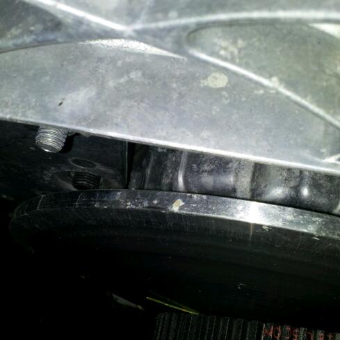

Working on my 500 mile service and noticed both front motor mount bolts don't have nuts and the engine is loose in the frame. Am I the only one to ever find this condition before? :o| No marks on the bolts or bulkhead to indicate they were ever there either.

Thought I would see if anyone had seen this before it goes back to the dealer.
No the rear mount is tight, but if you rock the sled from side to side the motor clicks between the deltabox. Actually looking at my pictures I am starting to wonder if the dealer made some repairs, looks like it's missing a rivet too. Hope buying a demo doesn't come back to haunt me. :drink:
Well the dealer repaired the sled last weekend and so far so good. As I suspected, "he remembered a sled that was repaired due to crate damage, but couldn't remember if it was this one". Really, guess I shouldn't be to surprised, I'm sure it happens all the time. :drink:
