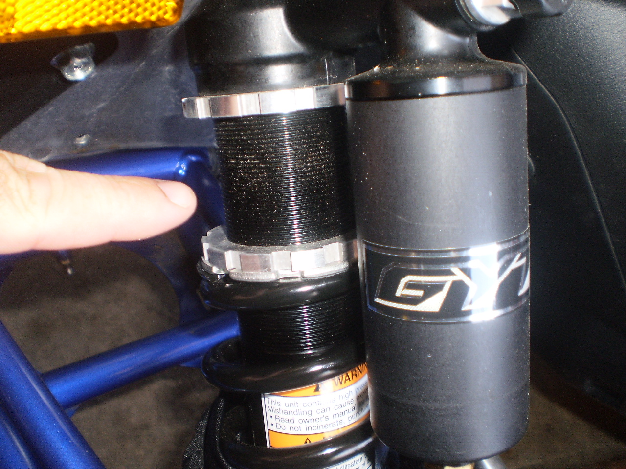

In the attached pics, where I'm pointing is the measured distances.
1 7/8" for the front shocks
1 1/8" for the transfer rod.
As far as the Mono pre-load goes, I feel the the compression & rebound settings are far more valuable than pre-load. Yes, the pre-load should be set for rider weight, (that's why I had to back it off for my wife) but clicker settings will control the ride.
I still feel the middle notch is the best place for the Mono to be set, unless the rider is very light ( under 150 lbs ) I weigh 235 lbs geared up & rarely bottom the Vector on the middle notch. If I do bottom it out, I just click the dial another 1-2 harder.
