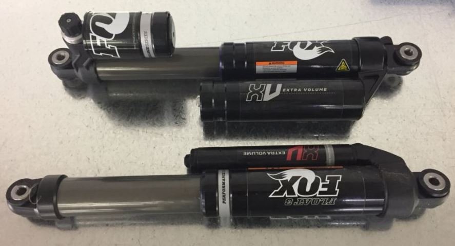

It should have updated fox rear shocks with compression and rebound dampening. If it doesn't, get the updated shock and set air pressure for weight and ride.
1.25 lug track and 1.75 lug track have different gearing in chaincase.

The 2016 did not come with the updated Fox shock but Yamaha did offer customers, albeit Apex owners and not Vector owners, the free upgrade kit but with this one only having 900km, what are the chance the original owner did the upgrade.
Only way to know is to check: Upgraded shock on top, stock shock on the bottom:
As for the updated Fox shock, Port Yamaha still has them on sale on their eBay store as I recently purchased one.
