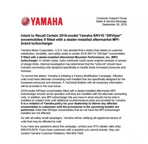

Trail turboTrail only? Or 240 kit?
Good news guys!

Great news! I talked to dealer at Big East Show and they hadn't heard about this. Hopefully dealers will get info soon before snow flies.

This is great news- now to figure out what to do with the 16 owners who had intentions to install the turbo but didnt do it right away. I tried to trade mine in for a sidewinder but the dealer told me because of the rod issues that my 16 was worth much less than a 2014 model. It would be nice to get the rods fixed so I could turbo my sled.Good news guys!
From what it looks like the 2017 part numbers are the same as the 2016- which would mean yamaha is agreeing that it was just a bad batch and a design change wasnt needed-which is good news to me.
How many would also trust their dealers to install the rods or should yamaha be sending sealed replacement engines?
Right. Hopefully they identified the 16.5 motors which had the weak rods. Based on Hurricanes posts here it's not all the new motors and the 16's with old motors were also fine. The TSB will have the serial numbers.This is great news- now to figure out what to do with the 16 owners who had intentions to install the turbo but didnt do it right away. I tried to trade mine in for a sidewinder but the dealer told me because of the rod issues that my 16 was worth much less than a 2014 model. It would be nice to get the rods fixed so I could turbo my sled.
From what it looks like the 2017 part numbers are the same as the 2016- which would mean yamaha is agreeing that it was just a bad batch and a design change wasnt needed which is good news to me

That's good news for Everyon with a 2016.5.Good news guys!

Good work Yammie! Couldn't be happier.

Game changer here. I would half consider a Viper with turbo instead of ponying up for a SW. Still needs to be able to beat a turbo 1200 Doo though.
