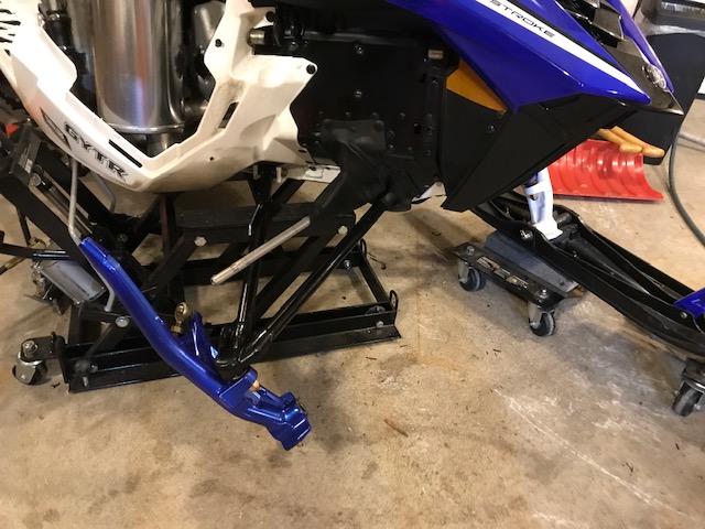

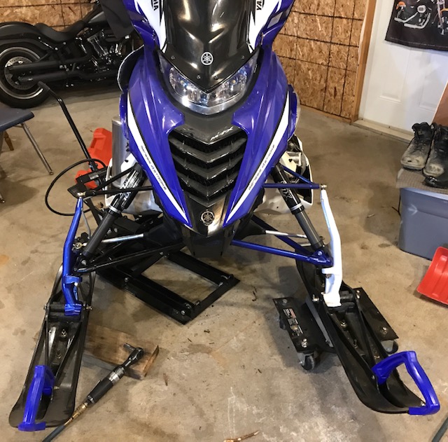

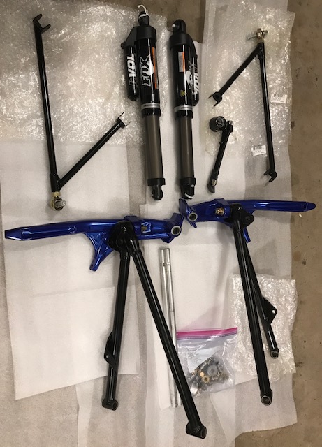

I'm not sure if the previous owner ever changed anything but... I bought the frt end off the 2017 Sidewinder, & it was very straight forward, (was just bolt it up and go on the 2016 Viper XTX 153 like Joseph had said in an earlier post.) I did use the existing bushings out of the 2016 arms I took off, and everything fit, & bolted right up perfect. (Bold size were all the same). I posted some pics incase it helps someone else who's wondering the same question I had, again check things out for yourself, but it worked for me here perfect. Now, can't wait for some snow to try it out. Cheers!
