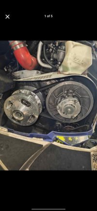

I would have opened up the chain case before ordering a bunch of that. I would bet its already got it if its has a Tapp clutch on it. Secondary helix looks billet too.
21/49 is the stock gearing, you can run a bit taller depending on the riding you are doing,
I probably wouldn't fart around with the clutching and tune very much, it would appear previous owner has probably spent a good deal of time and effort getting it to where it is unless he stated otherwise when you bought it.
