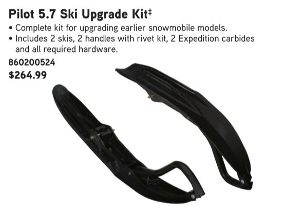

Yeah, Yammie and skis just dont seem to ever work.....lol
Cat ski is a simple single keep design, and will need a dual runner to avoid darting, been there tried that.
Pilot 5.7 is cheapest(by far) and seems to work BETTER then all the pricey skis out there(6.9 abit more money but still cheaper then most)...Grab a 5.7 kit for around 200 bucks(MSRP 264 with all-see below) from most any BRP dealer.
Part #860200524

Dan, what is the difference between the 5.7's and 6.9's? Besides price! Just starting to learn about these skis.

Not alot really....the obvious is the widths (5.7" vs 6.9") which allows for a much better flotation on the heavy nosed 4s engine sleds...the 12004tec DOO works so well with 6.9s, even for trail riders like me, on LAKE RUNS where we are on a lake which may not be rode on alot, there can be alot of powder....these 6.9s get ontop when you get just abit of speed up vs a 5.7 wont do that very well with all the nose weight, and the 6.9s become fun when you crack the throttle on those powder lakes as the nose will just sit way up ontop.Dan, what is the difference between the 5.7's and 6.9's? Besides price! Just starting to learn about these skis.
Other things I notice that mean alot to me.....The inside edge of the 6.9s have a nice ridge/edge....another thing to help with darting, where as the 5.7 does not have this on the inside edge.
Also, while the designs are similar, with a 6.9 the spacing between the two carbides is greater. Since they are wider overall. What this does is gives you a much MORE UNIQUE carbide track on the trails....You must remember the 5.7/DOO is the single most popular ski/sled on snow period! So with a 6.9, you wont be following the majority of tracks/ruts left by the most popular sled/ski combo.
Mounting them to spindle is same, shimming them same, carbide mounting same, handles/loops same.
I will add the 6.9s over time may tend to warp more then a 5.7 will. Being a wider ski I notice the outer carbide gets pushed up moreso, where a 5.7 seems to have a better longevity. These pilots are a light ski, not super heavy constructed/designed so they wont last forever when compared to a aftermarket ski, but for the cost I think they are still a better buy. 6.9s are harder and harder to come by as they are not being produced anymore....5.7s are cheap and readily produced and easy to find.
As with any ski, be SURE to watch carbide life, and REPLACE the carbides before any wear gets into the plastic, as the skis can wear out in just minutes without good carbide. And ALWAYS run outer carbides, even though doo sells the skis/sleds without outers, they will wear out fast. Doo knows how to make people buy their stuff, lots of throw away stuff from BRP for certain.
