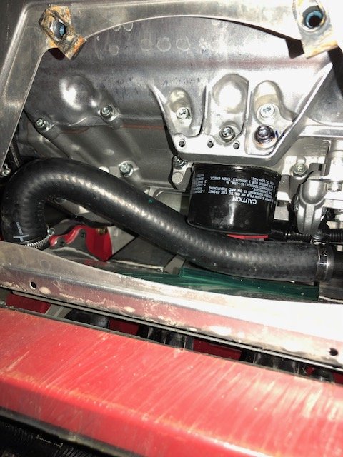

Ok, got the sled up and ready for first oil change, panel was easy to remove
With Panel removed the filter and drain plug are a breeze to access
Remember to drain from plug before removing the oil filter.
Once completely drained remove filter with proper tool
Here is the Yamaha kit and tool for the job

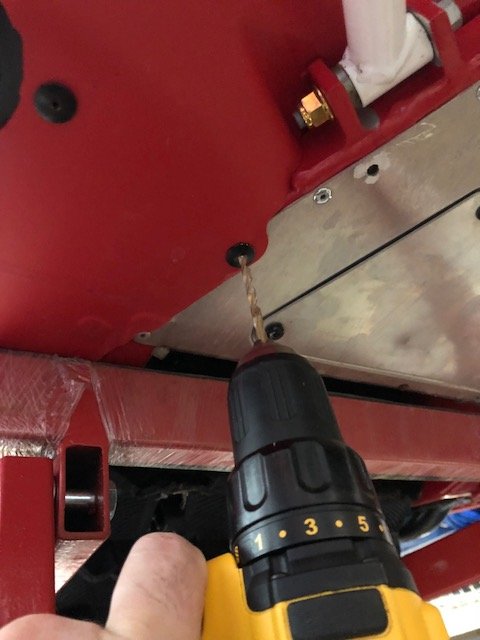

Ok so now the block is drained, time to access the oil tank drain plug. Not easy with factory set up.
Recommendation (not required): remove the lower right side panel by drilling out rivets and installing rivnuts or nutserts.
Tools required are simple for removal:
Tools required drill and 3/16 drill bit
I used a 12” drill bit for rivets next to shock tower

I had an issue with a broken bit inside the rivet, oops. I call it a beginner mistake, see photos. I was able to punch out the rivet without issues.
