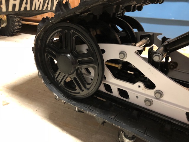

Ok, completed the “rivnut challenge”. It went alright once I had the right tools for the job. Watch my video to see what Rivnut tool to buy
Wingwong
- Mar 20, 2018
- 322
- 196
- 188
TOOLS AQUIRED:
I picked up a few different sizes of rivnuts. In the end I went with aluminum M6 all around except for one. The rivnut to the left of shock tower is SS M6.
Turned out well. Will change bolts soon, just used SS for now.
