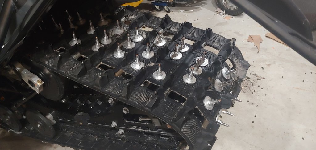

Sorry yah I forgot to mention that. I actually went with Extreme Max studs to try them and to keep the $ down because I already had put iGrips in the lugs (which I didn't find had enough grip for me on the windsweep lakes I have around me). For an NA application with the mods you have planned I would think the Woody's 1.450 would be the way to go.

I was trying to find out the exact difference in the 1.325 and the 1.450. It doesn't seem like to much. Maybe a 1/8th inch or so. Which I don't think is enough to harm me in any way. With your 1.52's how much over the lug do you have?Sorry yah I forgot to mention that. I actually went with Extreme Max studs to try them and to keep the $ down because I already had put iGrips in the lugs (which I didn't find had enough grip for me on the windsweep lakes I have around me). For an NA application with the mods you have planned I would think the Woody's 1.450 would be the way to go.View attachment 155150

The Extreme 1.52's have a total length of 1.830" so it looks like they are comparible to the Woody's 1.450 series which is 1.852" long. Should be 0.4" or so over the lug.
The Woody's 1.325 series as you state is 1.730" long so only a 0.122" (1/8") difference.
Why everyone uses different naming of there studs is a mystery to me. LOL
