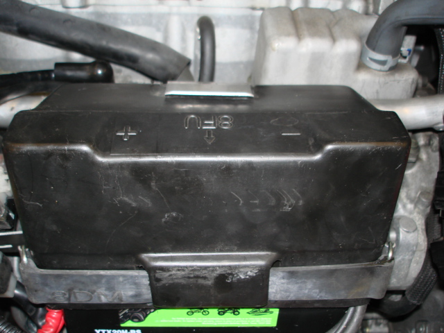

You may want to upgrade now to the YTX20H-BS which will fit perfectly with the original foam spacers removed. The polarity is correct. The bracket and cover do not need to be modified. This battery has 310 CCA compared to the original battery which has 200 CCA. It is a few more pounds but the extra CCA is worth it IMO.

That big battery is what the old rx1's used. For whatever reason in my rx1 at the time only lasted 3 seasons. my 07 apex still has the origonal.

Is that battery a AGM?
Yes
