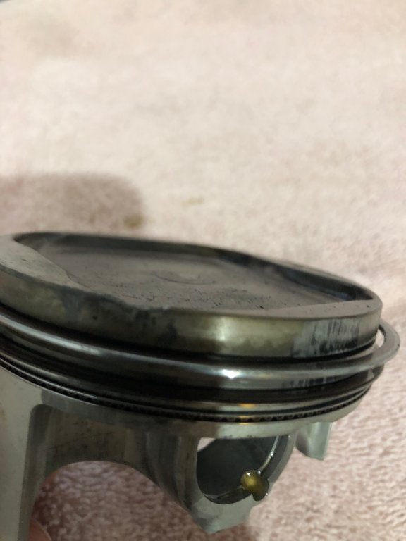

Hmmm, these pics look very familiar. Simlar to the ones I first posted when I started this string. I bet there are plenty of engines out there with similar deto damage where the owners think all is well because they are still sounding and running ok. It's just a matter of time before the damage gets bad enough to cause misfire or lower compression in one hole and the engine sounds "funny" when you crank it to start it (and/or you have to reduce primary clutch weight to run same RPM = loss of HP).Yes, to educate some of us that the fact that Detonation related to Tunes DOES happen and you need to be careful.
IMO, with today's gas getting worse and worse, I don't think the tunes with 17 lbs or more of boost are really pump gas safe.
