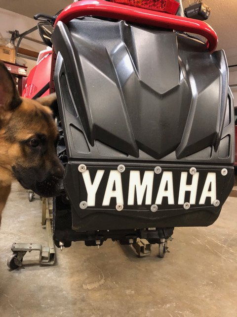

I riveted an extension on my flap to help with cooling for that very reason.
My photo bombing pup approves of the work too.
28 inch snowflap.

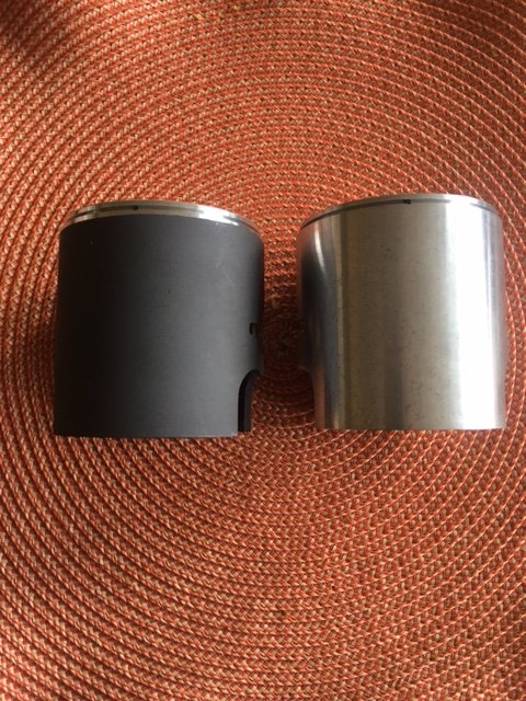

@Turboflash any picts of the swain tech pistons? What are you hoping is the temp reduction the slug will see?

I'll post pics when I find them.@Turboflash any picts of the swain tech pistons? What are you hoping is the temp reduction the slug will see?
From Swain Tech (https://swaintech.com/race-coatings/race-coating-descriptions/piston-domes/) site:
Gold Coat™ – This Ceramic Thermal Barrier designed specifically for pistons in extreme environments such as nitrous, turbo, and superchargers. About .003” thick.
GoldCoat™ Ceramic Armor™ Ceramic Thermal Barrier:
As the use of Nitrous, Turbo Chargers and Super Chargers have become common place; Swain Tech developed GoldCoat™ Ceramic Armor™ to protect piston tops in these demanding motors. GoldCoat™ offers the same benefits of TBC™, but adds an extra layer of extra high temperature ceramic to provide even more protection at higher temperatures. GoldCoat™ deals with the heat spikes and thermal shock of boosted motors better than any other piston coating. Now in its 5th generation of development, Swain’s TBC™ uses Swain’s exclusive “Smart Coat” technology which allows the ceramic to expand at the same rate as the piston. TBC™ coated pistons run cooler and retain much more of their tensile strength. TBC™ protects against high temperature oxidation, eliminates hot spots, and encourages proper flame travel. The ceramic also spreads the heat evenly over the entire coated surface reducing detonation, pre-ignition and allowing the use of lower octane fuel. Less heat is conducted through the wrist pins and rods keeping the crank, bearings, oil and entire bottom end cooler.
The don't post exact figures as far as piston temp reduction. On phone, they will often state about a 25% reduction in piston temp. I just figured it can't hurt to keep piston cooler so I went with their Gold Armor Ceramic coating on domes. Also, while it may be tempting to coat the piston skirts with their PC9 super slippery coating, there isn't enough piston clearance in these 998s for it. That coating builds about .0015 per side. Piston clearance in 998 is only about .0025 total so subtracting about .003 would leave no clearance at all. Not good.
I have used Swain Tech coatings when replacing pistons on my mod and stock two strokes for a couple decades and have been very happy with the results. The skirt coating can be use to tighten up piston clearances on slightly worn cylinders as well.
Here are pictures of coated pistons compared to uncoated pistons that I recently installed in my 440 Moto Ski engine rebuild.
