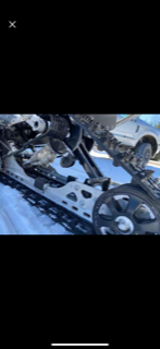

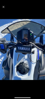

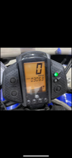

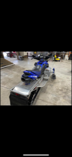

Sounds great. Here are some pics he sent me on the chain case. What would this sled be worth do you think?

Looks like he took apart the reverse gear case and replaced just the shaft that goes from the secondary clutch into the gear case.
