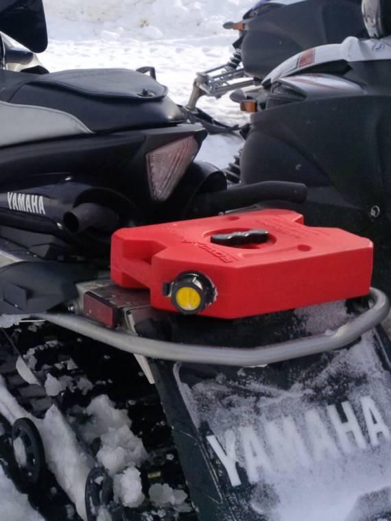

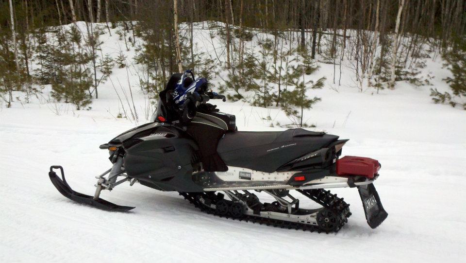

I have been using a Koplin 1.5gal on the rear of my Apex LTX for couple years now without any heat issue's and no turn outs. Only thing to watch out for was my rear cooler was really close so had to move my mounting bracket and tunnel 2 in back. Strattles the bumper. Great to have the extra fuel for sure!

That's the answers I needed guys, thank you!
BlueBullet, that's cool to see as the Kolpin and Rotopax are the same animal. I'm not sure who makes it for whom, but they are the same and come in the same quantities.
The LTX should have similar space in back as my XTX. Great photos! I will have to look at the mounts and see how it will work on my tunnel. The '12 does have a different exhaust outlet with between 2.5" and 3" of clearance below. I will have to measure. And check out my rear exchanger underneath too.
