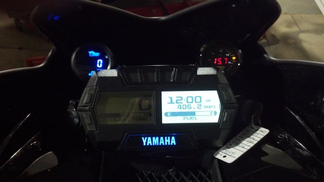

Is it easy to read?Innovative has a good product and you can get them at Ulmer along with the mount.

yes they are very bright and easy to read. not the best pic but gives a good ideaIs it easy to read?
