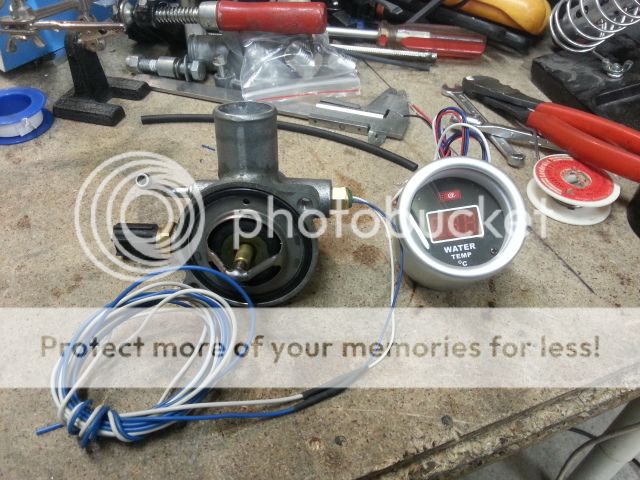

I was told by a reliable source you can drill and tap an aftermarket temp sensor into your stock Nytro T-stat housing. You just drill out the center of passageway in the pictured casting boss and then tap it for your sensor (see picture). Has anyone else done this and how did it work?

Cool! Thanks for the post and I'll be sure to add it to my build write up.

I did this also! Much better than cutting up a coolant hose and adding a t- fitting.
