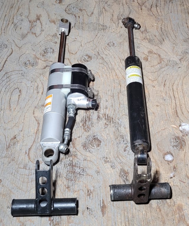

I was checking out the center shock absorber last night since I brought it home and measured the distance between the adjusting nut and the center of the bottom mounting point. I measured 3 1/2 inches of distance. The (soft) and (standard) setting is supposed to measure at 4.81 inches of distance.... so the shock was set super soft and then he had the rear torsion springs set to hard. This along with the missing hardware and poor assembly of how he had set up the main pivot arm probably caused the bending of both pivot arms, this is my suspicion anywaysGood lord, two pivot arm brackets bent? Was the previous owner a retired sumo wrestler and his wife?

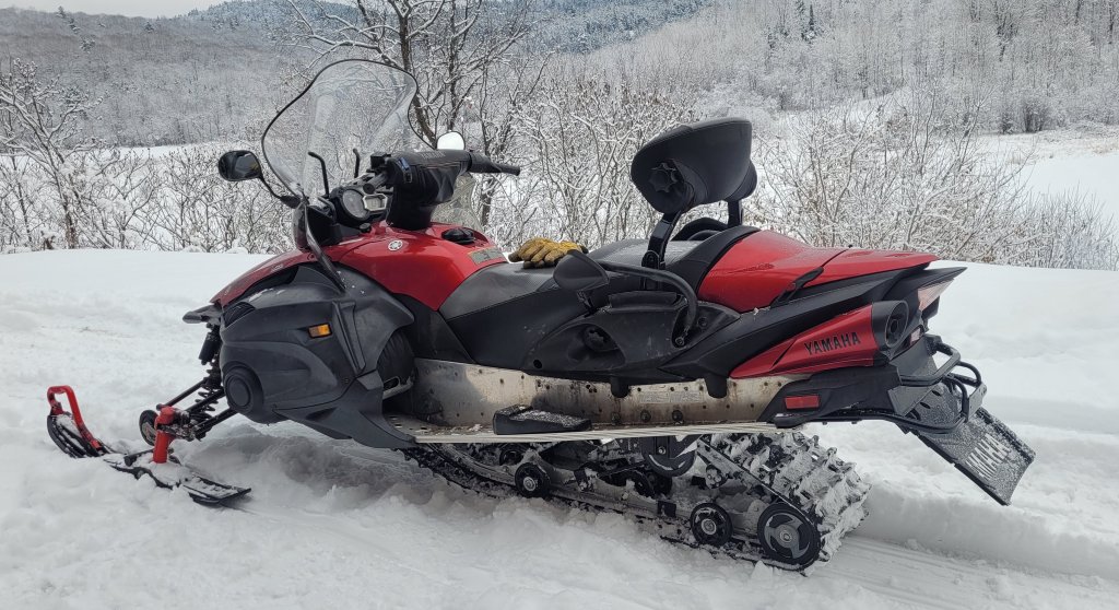

I was finally able to install my last pivot arm and rear shock over the weekend. A few weeks ago I had noticed that the rear shock had hit the the pivot arm making an indent in it... This thing has really had a true domino effect from whatever the previous owner did with his machine. I was also able to take her out of the shed, few things left to do are new rails due to some damage as well as possibly new rear guide wheels (I think the bearing is shot or has seized since you can see that the bolt is shifting towards the back inside the wheel). I also installed a new stopper flap and flap.

I'd say it wasn't put together properly at some point, and that may have also caused the bending.I was finally able to install my last pivot arm and rear shock over the weekend. A few weeks ago I had noticed that the rear shock had hit the the pivot arm making an indent in it... This thing has really had a true domino effect from whatever the previous owner did with his machine. I was also able to take her out of the shed, few things left to do are new rails due to some damage as well as possibly new rear guide wheels (I think the bearing is shot or has seized since you can see that the bolt is shifting towards the back inside the wheel). I also installed a new stopper flap and flap.
