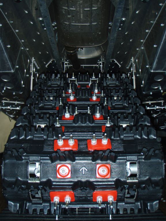

I would be careful. I did alot of research before studding mine and everybody said not to stud the outside. enclosed is mine with 144 up the middle. and it hooks up well and brakes much better. and as for cornering I think studding the outside may make the sled flip instead of slip. Just my two cents.
