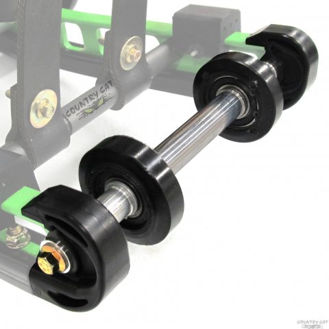

Where is the proper location for the Anti-stab kit. Directions with the Wahl kit shows what looks like the very end of the rails. Not sure if it matters but I have an RTX LE. Thanks for the help.
Your kit did not come up new rail tips?
Put them on and they line up where you drill the rail holes larger. Here are a couple photos. The antistab kit shown is the BDX kit. image.jpgimage.jpg
The kit from Wahl does not have new tips. Just looks odd to me that the wheels on the Anti-stab kit just kind of dangle in space.
I put the kit in over the weekend. Replace the bar that attaches to the limiter straps. You will need to drill the hole bigger but it fits just fine.
Thanks
I would HIGHLY recommend putting the anti stab kit into the rail cap holes. Other wise, what are you really preventing?? The rail tip can still stab the track window. It needs to be in the furthest forward hole on the rail.
Is the kit needed on a RTX-LE? Thanks
Maybe that kit is really not a antistab kit but one to address wear or drag. I kept my original slides and that (right by limiter strap bar) is one spot there is more wear than other areas..
No. I wouldn't worry about track stab in this chassis with any track unless it's the 3.0 pitch 141 and longer. It can't hurt to add to a 129 and 137 and may help with hyfax wear and technically might help in some crazy failure.... but if you are considering adding one to those shorther tracks only for fear track stab.....put the money back in your pocket.
To the original poster, if it didn't come with rail caps, drill out your originals and reuse them with the stab kit. I keep seeing guys buy the Wahl kits. Go with the BDX or Cat kit and you have everything you need and no questions.
