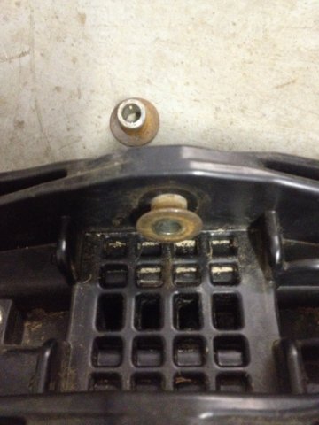

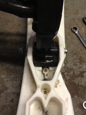

Did some trial fit ups today and the stock Viper ski bumpers and hardware can be used to mount a set of curve skis. This saves you from having to buy the $41 mounting kit. Here's what you need to do:
remove the steel inserts from the stock viper skis and transfer them to the curve
the viper ski rubber has a bunch of nubs on the bottom. If you trim the nubs with a tin snips it sits low enough in the curve ski saddle to work
re use the stock ski mounting bolt, nut and washers.
How is the side to side clearance of the saddle like this? I found mine quite loose. I just ended up drawing the ski tight, but it ends up like this: / \
hibshman25
Vendor
- Sep 25, 2005
- 2,881
- 2,772
- Lebanon, PA 17042
- 2017 sidewinder ltx dx
2018 snoscoot
The side to side was nearly perfect on ski I fit up this morning. It took a little force to get spindle in saddle. Def not loose like you describe.
You could just shim with some washers if yours is loose.
I did my install in a hurry before the March Muni ride. I'll have to go back and recheck. shimming with washers should do it, but a guy shouldn't have to especially when wrangling the bolts in place against the rubbers.
Ive tried numerous skis on the viper and when that happens it is best to use a few washers as spacers. It is better to be too wide and shim down than too narrow.How is the side to side clearance of the saddle like this? I found mine quite loose. I just ended up drawing the ski tight, but it ends up like this: / \

Stock ski rubber with nubs trimmed
Ski installed
Inserts that get transferred from stock ski.
